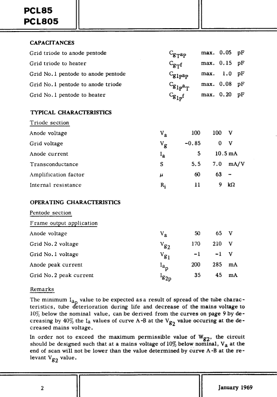

                        图片:
                        AD8620:  精密、低输入偏置电流、宽带宽JFET运算放大器(双路)
AD8610(单路)和AD8620(双路)均为精度极高的JFET输入放大器,具有超低失调电压和漂移、极低输入电压和电流噪声、极低输入偏置电流和宽带宽等特性。与其它许多JFET放大器不同,AD8610的输入偏置电流在整个工作温度范围内都很低。AD8610能够以同相单位增益稳定驱动1000 pF以上的容性负载,在更高噪声增益时则可以轻松驱动更大的容性负载。即使具有1 kΩ负载,AD8610的摆幅也能达到电源电压的1.2 V范围内,从而在有限的电源电压下也能获得最大的动态范围。在反相或同相增益配置中,输出压摆率均为50 V/μs,达到0.01%精度的建立时间不到600 ns。AD8610还拥有高输入阻抗、出色的精度和极高的输出驱动能力,从而成为驱动高性能模数转换器输入及缓冲数模转换器输出的理想放大器。
AD8610和AD8620的具体应用包括:电子仪器仪表;ATE放大、缓冲和积分器电路;CAT/MRI/超声医疗仪器仪表;仪器级光电二极管放大;快速精密滤波器(包括PLL滤波器);以及高质量音频。
AD8610的额定温度范围为-40° C至+125° C扩展工业温度范围。AD8610提供8引脚窄体SOIC和小型MSOP8表面贴装两种封装。AD8620提供8引脚窄体SOIC封装。MSOP8封装器件仅提供卷带和卷盘形式。

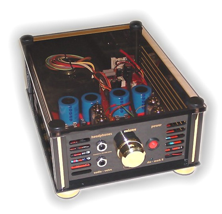

無論您是不是一個音響迷,相信都聽過這樣一句話"聽音響還是要聽真空管的最好",姑且不論此言是否為絕對之理,但至少點出了類比聲音透過真空管放大後的迷人之處。相較於晶體機,真空管擴大機比較容易營造出一股溫暖的氛圍,尤其那滿是韻味的中頻更是容易令人陶醉於音樂之中,德國 AudioValve RKV MKII 耳機擴大器正是箇中翹楚。
華麗於外 首先 RKV MKII 擁有一個高貴華麗的外觀,全機以永不退流行的黑色為基調,烤漆質感細緻而大方,再搭配大型金色音量旋鈕及角墊,黑與金交錯出一股專屬於德國 Hi-End 器材的貴氣。上蓋部分採用厚度達一公分的全透明壓克力版,結構完整外另有一股視覺協調之感。
精華其中
RKV MKII 上蓋採取全透明設計有另一個重要功\\能,使用者對內部線路及用料可以一覽無遺,廠家唯有在對自己產品有百分百信心時才會如此設計。日本大廠 DENON 以及美國重低音品牌 Velodyne 在推出旗艦產品時,專門置於展覽會場的展示機也有採取全透明上蓋之設計,但此舉在量產機型上則相當少見。

RKV阻抗匹配器是四个档位的,
audio valve
RKV Mark II headphone amplifier
as reviewed by Carlo Flores
Let me tell you one of the reasons I like Dr. Jan Meier. After he read my review of his HA-2 headphone amp, he told me that I favored tube sound (I do), and asked if I had heard the Audio Valve RKV Mark II.  A week or so later, PFO received one for review. I do not know of another instance in which one manufacturer offered another's product for review, although I should point out that Dr. Meier distributes Audio Valve products in North America. Meier seems to care more about his customer's needs than he does about hyping his designs. I mention this because I consider the HA-2 the standard for performance/price, against which I must measure the RKV.
Audio Valve's RKV Mark II is an OTL tube amp that measures a little over 5 x 9 x 12 inches in size and is priced at $1050 shipped. According to Audio Valve's website (www.audiovalve), it was designed by Helmut Becker to drive any load between 32 and 2000 ohms, but it could not quietly drive my 40-ohm Grado HP-1 headphones without a transformer (an option packaged as the $180 Impedancer), so I used my Sennheiser HD580s. Finding replacements for the RKV's set of four Tungstram PCL805 tubes is said to be easy, although I believe that tube rollers will find limited options. The amp's piano black finish with gold trim is more garish than elegant—it would look sharp in Snoop's crib, but a picky girlfriend may give grief. Its paralleled pair of single-ended inputs means that it can act as a two-source headphone amplifier or function between a source and preamp. An IEC receptacle and two headphone jacks are included. The top lid is made of a transparent material and is secured with metal thumbscrews, which allows easy access to tubes and fuses as well as amorous glances at its sexy red PCBs.
There's a lot I like about the amp. It was so good during the first month that I felt seduced. I think of music reproduction as a three-part process—attack, body, and decay—and I give the RKV good marks in each. It has an almost lush sound, full but not bloated. Even when paired with an average-sounding digital source like my modified Sony CE-775, the amp contributed an analog-like reverb to strings. It sounded noticeably fatter and sexier than the HA-2. For example, Pulp's Intro—The Gift Recordings has lots of crazy riffs that sound electric and awesome with most amps, the HA-2 included, but dominating with the RKV. For you audiophiles, Norah Jones sounded huge.
I can't overstate that the RKV makes music sound damn good. It's all about midrange, bass, and decay, though I'm not saying that the high frequencies suffer, because they don't. I am not talking about impact or detail, but about finding the music. The word that comes quickest is "wet." Notes sound wet when played through the RKV. A groovy acoustic guitar, such as Jonathan Richman's, has adequate groove, which is an accomplishment for a system featuring the HD580s. I'm also talking about the kind of soundstage that makes me forget I'm wearing headphones.
Magnifying this is bass performance that pushed the Sennheisers to their limit. I prefer a quick midbass and a direct relationship between the lowering of frequency and a note's thickness, and the RKV gives me what I want. The Sonics' foundation, Serge Gainsbourg's pace, and Mos Def's beats just sounded right, and involved me as a listener. I've heard more expensive amps mess up the lower notes. Unlike them, the RKV ‘s separation between bass notes is distinct, and while their impact is somewhat weak, instruments have adequate weight.  When the foundation of notes is this good, I find myself turning into a bass head.
What did I lose to get that scale? A great amp gives up very little, if anything. HA-2 doesn't even try to sound big, preferring to achieve frequency balance, and it offers Dr. Meier's cross-feed to recordings that need consolation. The RKV ignores audiophile sensibilities, offering gray backgrounds and little resolution at low levels. While the stage is very wide, placement within that stage is fuzzy at best. It's easy to focus on one instrument—to ride a stringed instrument or be caught in a piano—and get lost when listening to the RKV. However, place that instrument in relation to the others, and things turn messy. As with badly set up speakers, the image of each performer is soft and indistinct. People who want scale in a small room with reflection problems know what I'm talking about—the nuance is gone. Albums sound good, but hardly ever interesting. If you owned this amp, why would you invest in high-quality recordings when you cannot hear their full potential? This is a music lover's amp, not an audiophile's.
I have not mentioned my reference headphone source, the Audio Note 2.1x CD player, because it does not complement the RKV and the HD580. Instead, it yields an unbalanced but juicy sound, appealing at times (Nick Cave's piano in the song "Into My Arms") and irritating at others (Nick Cave and The Bad Seeds' album Murder Ballads). Unlike the HA-2, which mates well with even the most flavored sources, the RKV gets in the way. In the end, the RKV is a designer Band-Aid that will help a system that needs to add flesh to notes. It probably would have been great with my old reference, an Arcam Alpha 9, or other typically dry British sources. The RKV only disappears at moments, depending upon song and instrument. As much as I like this amp, I believe it has too many flaws—its inability to drive low-impedance headphones, its high noise floor, and its lack of balance—at $1195. The HA-2 can be the foundation of a system. Find the headphone you want and it'll drive it. Choose a flavored or unflavored source and you'll hear the characteristics the designer wants you to hear. It costs almost half as much, and it comes with cross-feed. For me, this just isn't a contest.
After about a month and a half of listening to the RKV, I received an Impedancer for review (to the left of the RKV above). The Impedancer is a passive device meant to match its load to its input. It is a stand-alone product that will work with other headphone amps. It has a small footprint, and will fit comfortably next to an RKV in a standard-width stand. The Impedancer's rotary bypass control is a gold knob that matches the RKV's volume knob. On the front face are gold-plated speaker binding posts, turning this into an integrated amplifier for high efficiency speakers, which I did not try. There are also two headphone outputs on the front face. Most importantly, the Impedancer allows listeners to use the RKV with the dynamic headphones that matter, including Joseph Grado's HP-1000 series and Sony's R-10s.
The Impedancer and RKV together are quieter than the RKV alone. I found that I listened at my lowest levels using the two together. Considering the price of cables nowadays, $180 makes the Impedancer a no-brainer, even when using high-impedance headphones. Nevertheless, the Impedancer did not drastically change my opinion of the RKV/HD580 combination. After listening to the RKV with my Grado HP-1s, I realized that the soft-sounding Sennheisers, paired with the RKV, were more mush than lush. While the HD580s' and RKV's flaws overlap, the HP-1s' focus and leading line gave a sense of balance. Side-to-side placement was better than adequate, and the RKV's depth was in proportion to the HP-1s' somewhat shallow stage. On some recordings—Tom Waits' Blue Valentine, Aimee Mann's Bachelor #2, and Dylan's Time Out Of Mind, to name a few—the combination yielded a haunting and spatially interesting sound. Perhaps it was more pretty than natural, but I like that. The HA-2, Headroom Max, or Sugden Headmaster amps don't make me sink into a song quite like the RKV can with certain recordings.
Everything that was good with the RKV stayed good with the Impedancer and the HP-1s, especially bass. This was where the lowered noise floor of the Impedancer made an impact. My perception was that the top was faster and the bottom thicker. Still, other amps can go lower, and I can only wonder how this amp would sound with a completely black background. Again, the HP-1s complemented this amplifier, and the combination rocked. Hell, I spent a day listening to The Sonics and The Zombies because this system rocked so much. Not many amps feed my love for distortion and wicked midbass.
Yet I would not call this amp fast. It does better with sultry electronica (Tricky's Maxinquaye) than with trippy and fast electronica (Aphex Twin). Transient information doesn't pop out of the black, as it does on quieter components. Are excellent macrodynamics worth the loss of microdynamics? Is scale more important than subtlety? The RKV will always sounds like the RKV. I listen to albums I know and things sound different. Then I think about how good womens' voices sound with this system, and I reach for a Joni Mitchell album. I see why so many like the RKV.
The Impedancer is a required option, even if using it means only that so you can divorce yourself from Sennheisers. That makes this a $1230 system.  The RKV is at least the equal of the Headroom Max, though you will give up the Max's pitch-black background and winning linearity. I'd take the RKV over the Sugden Headmaster and many other amps, but I couldn't have it as my primary amp, and I don't think of it as a reference unit. Flavor doesn't matter unless the basics—again, black background, linearity, and separation—are addressed. The RKV, even with the Impedancer, only gets two correct. She's a nice change of pace, but not the girl I'd marry.
Update
After completing this review, I found out that an RKV Mark III is in the works. The Mark II is still available, but Positive Feedback is glad to pass along the first picture of its replacement. As you can see, the amp is still in the prototype stage. Dr. Meier told me that Helmut Becker has focused on low-impedance loads and a substantially lowered noise floor, eliminating the need for the Impedancer. As you can see, the input tubes are no longer the same as the output tubes, and while their type/family hasn't been released, they are more common than PL805s. This will be the first all-tube amp with cross-feed, and its price will be lower than the Mark II.  While this is exciting, I am skeptical about getting everything I want at a lower price. Still, this may be our first glimpse of one of the great sub-$1000 headphone amps. Carlo Flores
Audio Valve
web address: www.audiovalve
Meier Audio
web address: http://home.t-online.de/home/meier-audio
RKV MKII本身可用於32-2000ohm的耳机, 阻抗匹配器是针对特定常用的阻抗如8/16/32/64ohm四个档位进行调节,所以那个阻抗匹配器也就是只有四个定位,再扭就扭不动了。
阻抗匹配器还有一个最广泛的用途就是用上面的四个金色输出端
子接AKGk1000(或小功率需求的喇叭!), RKV MKIIk1000 的功力也是很著名的.
KK一向以难推著名, 耳扩中除一些特别设定的之外, 很少有能将KK推的好的, 一般都是出动到综扩, 但力道够并不代表声音必然好. 在驱动KK的二房中,RKV算是不错的一台。当然更好的应该是Cary SLI-80/CAD300SEI了。
RKV驱动KK在音乐性及细节方面表现不错, 换了管子和运放后,表现还能更进一步, Cary SLI-80/CAD300SEI和RKV最主要的表现差异是当在聆听大编制的音乐时气势会相 对强的
如果是驱动K701的话,连接在低阻适配器上,并调节到64ohm档位上,在RKV驱动下的K701声音大气饱满。两万元之内比RKV强的二房屈指可数了。
AKG KK转接线的接法:
1 白 左+
2 黑 左-
3 红 右+
4 兰 右-
[ 本帖最后由 davidxtb 于 2012-8-4 09:13 编辑 ]

买管子时一定要看明白了是PCL805还是PCL85,两者的素质有明显的差异
PCL805
Identical to                          PCL805
Similar Tubes                            Normally replaceable-slightly different:PCL85
First year  1968 Tube leaflet collection E.Erb Analysis by original leaflets
First Source(s)                            May.1968 : Funkschau (FS) 1968, Heft 9
Predecessor Tubes                                                          PCL85
Base     Noval, B9A
Was used byRadio/TV-reception etc.
FilamentVf 17.5 Volts / If: 0.3 Ampere / -: Indirect  / -: Series,  AC/DC  /
Description Usually used as field oscillator and output in TV receivers.
The PCL805 was issued with dual markings with the same data applicable to both (Mullard data Nov 1968)
However the PCL85 was a very badly designed valve which failed repeatedly. The replacement PCL805 was better - these tended to have a shortened life, though, if the cathode bias resistor which had been badly cooked by its predecessor hadn't been checked and replaced if necessary. (These carbon composition resistors tended to drop in value quite considerably and seriously over-ran the replacement valve if not replaced.)
Dimensions (WHD)
incl. pins / tip
22 x 79 x  mm / 0.87 x 3.11 x  inch
Tube prices 0 Tube prices (visible for members only)
Literature Manufacturers Literature
买管子的时候一定要看明白了是PCL805还是PCL85,两者的素质有明显的差异,虽然可能价格方面不会有什么差异。
